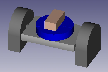

Use the Table Settings dialog to define the dimensions and appearance of a 5-axis rotary table on a milling machine when using Basic Simulation for both box and cylinder stock.
To display this dialog, click Settings on the Setup dialog and select Rotary 5 Axis from the Table Type list.

Simulation Settings
Use these settings to specify how you want the table to appear during Basic Simulation:
Table Transparency — Enter the transparency of the table when displayed in the Simulation window, where 0% displays a solid table and 100% displays a fully transparent (invisible) table.
Table Color — Click to display the Color dialog, where you can specify the color of the table during simulation.
Machine File — Click this button to display the Machine File dialog, which enables you to import settings from a machine file or export settings to a machine file.
Displaying the rotary table in simulation
You can display the rotary table in simulation by modifying the chuck data:
  1. Select the Use Chuck option on this dialog.
  2. In the Chuck Data dialog, set Jaw Transparency to 100%.
