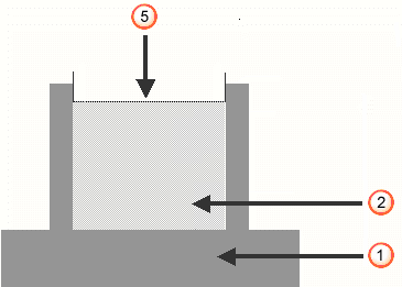

The first area clearance move clears the following:
Finished part
Material to be removed
Profile allowance
First area clearance move

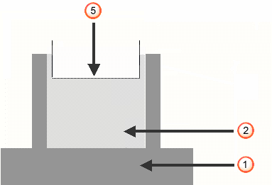

Followed by a second area clearance move:
Second area clearance move

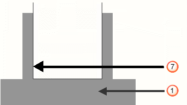

This is then followed by a single profile move:
Profile move
This technique can be used to finish the part with one final profiling pass where you cut on the side of the tool, though a finishing pass may be required.

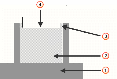

Finished part
Profile allowance

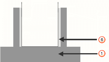

Followed by a profile move:
First profile move

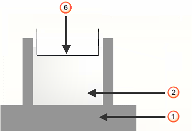

Then a second area clearance move:
