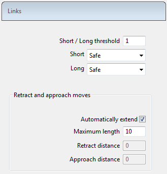

Use the Links page to specify how to make the link moves between the cutting moves in a toolpath.
Different types of link moves are available for connecting cutting moves.
Short links
Long links
Short/Long Threshold — Enter the distance at which a short link becomes a long link.

Retract and approach moves
This toolpath has Retract and Approach Moves set to 0:
This toolpath has Automatically extend selected:
This toolpath has Automatically extend deselected and a Retract and Approach distance of 10:
Retract along tool axis.
Retract normal to the safe plane.
Automatically extend — Select to lengthen the retract and approach moves made within rapid links. This enables the moves to reach the surface, over which the rapid or skim moves are made. This also lengthens the initial move at the start, and the final move at the end.
Maximum length — Enter the maximum length of the extension.
Retract distance — Enter thelength of the Retract move.
Approach distance — Enter the length of the Approach move.
