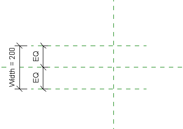

  2. Draw the profile: Create Detail Line. The profile must be defined left of the vertical reference plane, it must start from the bottom of the reference plane and end on top of the reference plane and it must be a continuous line. For example:
    The vertical reference plane is the edge of the hollow core element.
