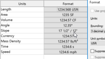

With this feature, you can change the Length unit to US survey feet in the Project Units dialog. Then all length parameters are in US survey feet.
Alternatively, you can set the units format for a type of spot coordinates without changing current project units settings. As a result, US survey feet is only used for coordinates which may be measured from the state plane coordinates origin.
