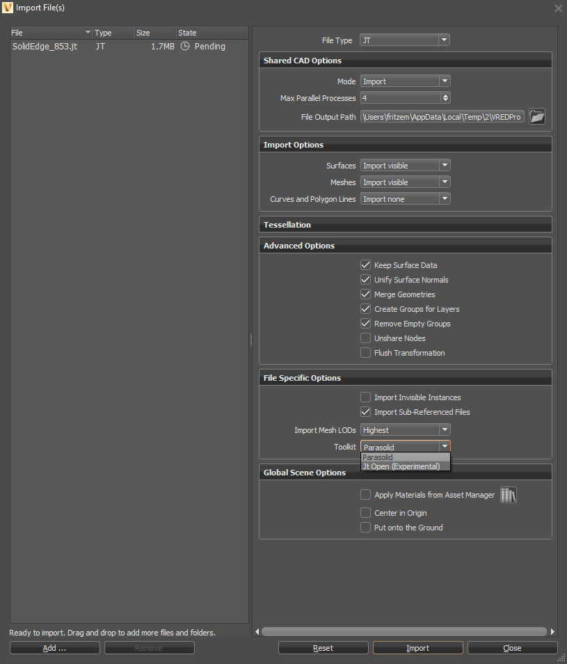

In the Menu Bar, click Edit > Preferences > FileIO > JT.
This section determines which surfaces, meshes, curves, and polylines are imported.
Specifies which surfaces are imported. Select one of the following:
Import none - No surfaces are imported.
Import visible - Only the visible surfaces are imported.
Import all - All surfaces, regardless of whether they are visible or not, are imported.
Specifies which meshes are imported. Select one of the following:
Import none - No meshes are imported.
Import visible - Only the visible meshes are imported.
Import all - All meshes, regardless of whether they are visible or not, are imported.
Specifies which curves and polylines are imported. Select one of the following:
Import none - No curves and polylines are imported.
Import visible - Only the visible curves and polylines are imported.
Import all - All curves and polylines, regardless of whether they are visible or not, are imported.
This section determines what gets tessellated.
Sets the level of tessellation applied, with Course being the lowest tessellation and least memory intensive to High or Custom (depending on the settings) being the highest quality and most intensive.
Sets tessellation for chord deviation.
Sets tessellation for the normal tolerance.
Sets tessellation for the maximum chord length.
Toggles the tessellation of stitching on or off.
Sets tessellation for stitching tolerance.
This section determines which advanced options, like source date, normals, and unshared nodes are enabled during import.
Toggles keeping source data on or off. When disabled, the source data is removed during import.
Toggles the unifying of surface normal direction on or off. When enabled, all surface normals are unified to face the same direction (out or in) during import. When disabled, surface normals are not changed during import.
Toggles the merging of geometries on or off. When enabled, all geometries are merged together during import.
Toggles the creation of groups for layers on or off. When enabled, layer groups are created during import.
Toggles the removal of empty groups on or off. When enabled, if any empty groups exist in your file, they will be removed during import.
Toggles the unsharing of nodes on or off. When enabled, nodes that are shared are no longer shared. When disabled, there is no change to shared nodes during import.
Stores the transformation data within objects themselves rather than in higher-level group nodes. In other words, if you have a hierarchy of transformation parent nodes of a geometry node, all of them are baked into one single matrix within the geometry; the original information is lost. You would want to avoid this, for example, for animating wheels on a moving car.
This section determines which file-specific options are enabled during import.
Toggles the import of invisible instances on or off. When enabled, invisible instances are import into VRED.
Toggles the import of sub-reference files on or off. When enabled, sub-reference files are import into VRED. This is enabled by default, as it is required then working with assemblies.
Controls how duplicate materials are handled when importing CAD assemblies and PLMXML files. When disabled, duplicate materials will NOT be merged. If an identical material is referenced by sub-referenced files, an additional instance of the material is created for every occurrence of the material in the import. This option is enabled by default.
Imports Static Mesh Levels of Detail (LOD) into VRED from 3D modeling applications, such as 3ds Max or Maya.
Choose from Lowest, Highest, and All. All imports all currently selected FBX files with specified VRED settings.
Sets the default JT import behavior used by VRED. Choose one of the following options:
Uses layer filters and disable inactive Nodes.
Manages objects with exact boundary representation surfaces. Use the options to load and tessellate all Breps, or load the Breps of your choosing without tessellating.
