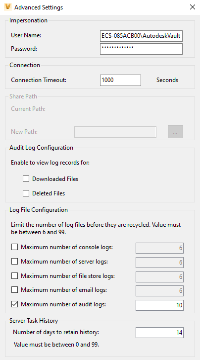

  1. Select Tools Administration.
  2. In the Global Settings dialog box, select the Advanced Settings tab.
  3. Click Settings.
  4. In the Audit Log Configuration area, select whether to enable to view log records for files downloaded and deleted from the Vault.
  5. Select the check box for the log type for which you want to modify the display limit and enter a new value. The minimum and default value is 6 logs. The maximum number of logs per type is 99.
  6. Click OK to save your changes.
