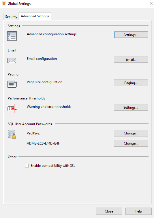

Fine tune your Vault Server performance and configure additional server settings, such as e-mail notifications and number of rows displayed on a page, on the Administration tab of the Global Settings dialog in the Autodesk Data Management Server Console.
Access Advanced Settings for the Vault Server
  1. In the ADMS Console, select Tools > Administration.
  2. In the Global Settings dialog box, select the Advanced Settings tab.

Advanced configuration settings
Configure the following advanced settings:
  • Impersonation credentials
  • Connection timeout threshold
  • New share path
  • How many log files are displayed
  • Number of days that you want the server to retain a history of server tasks.
Email configuration
Identify email recipients and send test email messages.
Page size configuration
Configure how rows of data are displayed on a page.
Warning and error thresholds
Configure performance thresholds.
SQL User Account Passwords
Change the password for the VaultSys and ADMS_%SiteName% SQL Service Accounts.
Enable compatibility with SSL
If your SMTP Server uses SSL, you can enable Vault Server compatibility.
