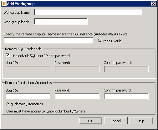

  9. On the publisher, right-click Workgroups again in the Vault server console and select Add Workgroup.
  10. Enter the appropriate information for the remote workgroup.
    If you created a replication user account, use those credentials under Remote Replication Credentials.

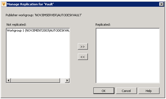

  2. On the publisher in the ADMS Console, right-click Workgroups and select Manage Replication.
  3. Select the Vault that you want to replicate.
  4. Move the workgroups you want to replicate into the Replicated column using the >> button.
