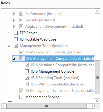

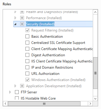

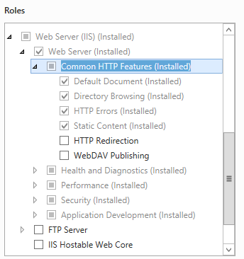

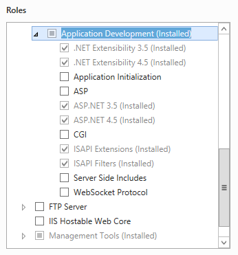

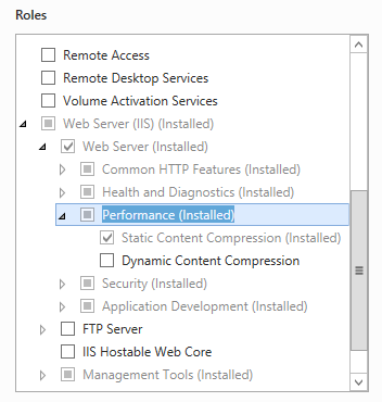

  7. On the Server Roles section, select the following Roles:
  8. Click Install.
