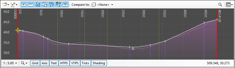

Profile View - View the entire collection of profile geometry associated with any selected Civil 3D alignment, and compare station and elevation values with other elements in your design.

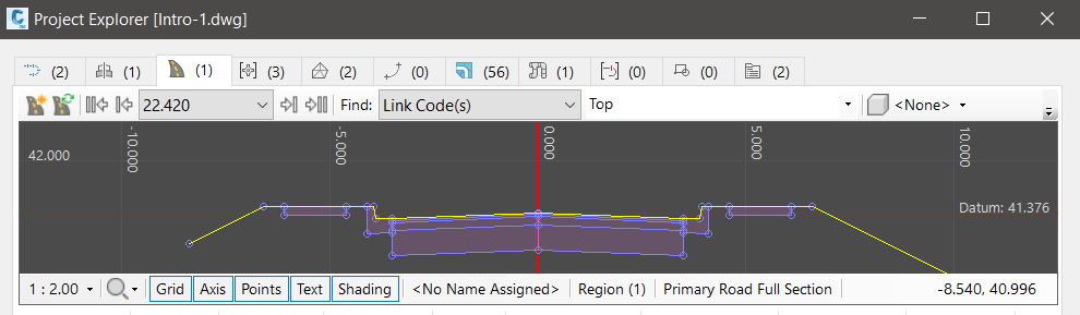

Corridor Section View - View a dynamic cross section through a corridor at any baseline station, and easily identify specific link, point, and shape codes, and individual subassemblies. Compare offset and elevation values with other elements in your design, such as existing ground surfaces.

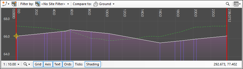

Feature Line View - View a dynamic profile along any selected site feature line, and compare station and elevation values from the selected line with other elements in your design.

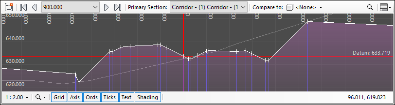

Sample Line Group Section View - View a dynamic cross section through the location of any sample line, including all associated section lines. Compare offset and elevation values with other elements in your design, such as existing ground surfaces.

The Profile View in the Alignments tab displays all profiles directly associated with the currently selected alignment or profile. If no profiles are associated with the selected alignment, the station extents of the alignment and every alignment entity are displayed as vertical lines across the canvas instead. Unselected profiles associated with the currently selected alignment or profile are displayed in the secondary profile color (grey by default). If a profile is currently selected, that profile is displayed in the primary profile color (white by default).
Use the Profile Type Visibility check buttons to include or exclude different types of profile from the alignments and profiles list.
To compare the station and elevation of points on the selected profile with other elements of your design, use the drop down list of objects adjacent to the Compare To label to select another alignment, profile, or surface in the current drawing. This will cause a compared profile line to be drawn on the profile view indicating the relationship between the compared object and the displayed profile. Additionally, the Calculated Stations list of points for the selected alignment or profile will show the compared elevation values and other relevant details for each displayed point.

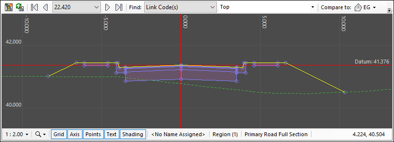

The Corridor View in the Corridors tab displays a dynamic section through the selected corridor at a range of station or chainage locations. Use the forward/back arrows or drop-down list of available stations in the Corridor to select the station at which to display a section. The Find option in the toolbar can then be used to highlight specific point, link or shape codes on the Corridor View. Codes can either be selected from a drop-down list, or typed into the field as a comma delimited list where multiple codes need to be highlighted.
To compare the offset and elevation of points on the selected corridor section with other elements of your design, use the drop down list of objects adjacent to the Compare To label to select any surface from the current drawing. This will cause a compared section line to be drawn on the Corridor View indicating the relationship between the compared surface and the displayed section. Additionally, the feature line points list for the selected corridor will show the compared surface elevation values and other relevant details for each feature line point.
The Feature Line View in the Feature Lines tab displays a dynamic profile through any selected feature line. Use the site filter in the main toolbar to limit the list of feature lines to all, or to specific sites in the current drawing. Use the editing tools from the right-click menus on the feature lines list or feature line points list to apply changes to the elevation of one or more displayed points.
To compare the station and elevation of points on the selected feature line with other elements of your design, use the drop down list of objects adjacent to the Compare To label to select another alignment, profile, or surface in the current drawing. This will cause a compared profile line to be drawn on the feature line view indicating the relationship between the compared object and the displayed feature line. Additionally, the feature line points list for the selected feature line will show the compared elevation values and other relevant details for each displayed point.

The Sample Line Group Section View in the Sample Line Groups tab displays a dynamic section through the selected sample line group at any sample line location. Use the forward/back arrows or drop-down list of available sample line stations to select the station at which to display a section. The Primary Section list in the toolbar can then be used to highlight specific point, link or shape codes on the Corridor View. Codes can either be selected from a drop-down list, or typed into the field as a comma delimited list where multiple codes need to be highlighted.
To compare the offset and elevation of points on the selected sample line section with other elements of your design, use the drop down list of objects adjacent to the Compare To label to select any surface from the current drawing. This will cause a compared section line to be drawn on the Corridor View indicating the relationship between the compared surface and the displayed section. Additionally, the section points list for the selected sample line will show the compared surface elevation values and other relevant details for each section point.
