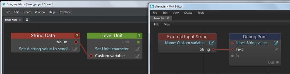

This category contains nodes that you can use to access data values that are set outside of your graph: in other Flow graphs, or in Lua scripts.
When you use this node in a unit Flow graph, in a Flow graph that you assign to an entity, or in a Flow subroutine, a new input data connection becomes available on the Flow node that represents this unit, entity or subroutine in other Flow graphs. Whenever your Flow graph reads the data value from this external input node, the value it receives is the last value passed by one of those other Flow graphs to that new data connection.
For example, the following image shows a Unit Flow graph that contains an External Input String node named Custom variable. When a Data > Level Unit node for this unit is used in a Level Flow graph, it automatically offers an input connection with the same name, that accepts string values. When the Unit Flow graph tries to read that external string value, it gets whatever value the Level Flow graph last passed in to that string input connection -- in this case, the text "A string value!".
External In Event
In addition, you can set external input variables from Lua by calling stingray.Unit.set_flow_variable(), or stingray.FlowComponent.set_flow_variable().
When you use this node in a level Flow graph, you can only set the input variable from Lua, by calling stingray.Level.set_flow_variable().
