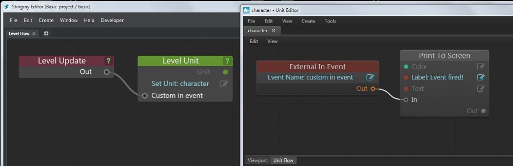

When you use this node in a Level Flow, you can trigger the external event from other Flow graphs by using the Level > Trigger Level Flow Event node.
When you use this node in a unit flow graph, in a flow graph that you assign to an entity, or in a flow subroutine, a new input event connection becomes available on the flow node that represents this unit, entity or subroutine in other Flow graphs. Whenever that other Flow graph passes an event along that new input connection, this external event node triggers within the flow graph of the unit, entity or subroutine.
For example, the following image shows a Unit Flow graph that contains an External In Event node named custom in event. When a Data > Level Unit node for this unit is used in a Level Flow graph, it automatically offers an input event with the same name. Triggering that event input in the Level Flow causes the unit's flow graph to begin evaluating, starting with the External In Event node.
External In Event
In addition, you can trigger this external event from Lua by calling stingray.Level.trigger_event(), stingray.Unit.flow_event(), or stingray.FlowComponent.flow_event().
