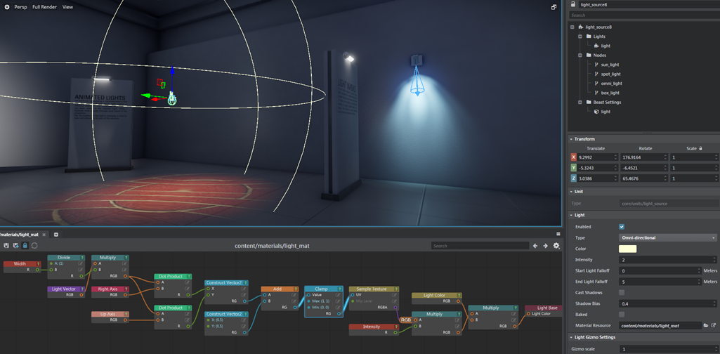

  5. Return to the Shader Graph Editor and set up your light material's shader graph the way you want it, so that it produces an output color for the light to emit.
    For example, the following graph makes a spotlight or omni-directional light emit a colored texture -- in this case, a brick pattern -- which is set up as a property for the material in the Property Editor.
