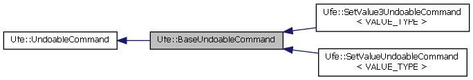

Inheritance diagram for Ufe::BaseUndoableCommand:
Collaboration diagram for Ufe::BaseUndoableCommand:
