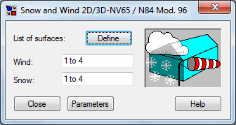

Open the Snow and Wind 2D/3D dialog using either method:
In the dialog, you specify a list of surfaces on which snow/wind load cases are to be generated. Clicking Define opens the Polyline - contour dialog that lets you define surfaces to which snow and wind loads will be applied. In the Wind and Snow fields, user-defined surfaces can be selected to generate wind and snow loads, respectively. You should specify base wind and snow pressure depending on the structure's site.
To specify parameters for automatically generating snow/wind loads, click Parameters to open a dialog to specify the parameters for a selected code.
