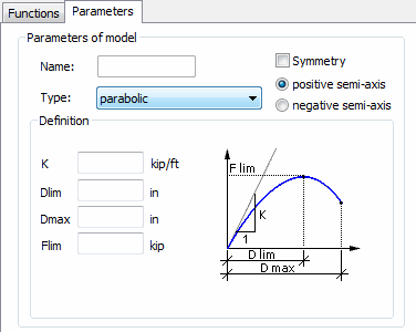

When the Parameters tab is selected on the Non-linear Model Definition dialog, the following displays.
The options on this tab let you define a non-linear model. At the top of the dialog, the Name field displays the name of the active non-linear model and the following options: Symmetry, positive semi-axis, and negative semi-axis. When Symmetry is selected, the options: positive semi-axis, and negative semi-axis are not available. Model definition concerns the positive axis; whereas, the negative axis is determined automatically based on the positive axis definition. If the Symmetry option is cleared, then the options: positive semi-axis and negative semi-axis are available, and they are defined separately.
The following non-linear types are available:
When a diagram is defined using the Function option, the quantities that characterize a function diagram are not recalculated, therefore, they should be defined in the base units of the Robot, that is, force (N), moment (Nm), displacement (m), and rotation (rad). In other cases, parameters describing individual functions are the quantities expressed in the units displayed in the dialogs, and they will be recalculated automatically after the units are changed.
The contents at the bottom of the dialog (Definition) depend on the selected non-linear type. Parameters are displayed that are necessary to define a non-linear model. The following parameters are available for the available types of non-linear models:
