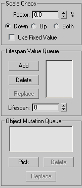

Scale Chaos group
These options apply random scaling to the particles.
- Factor
- Determines a random percentage range of scaling of the spawned particles relative to their parents, and dependent on the options below.
Down Randomly scales down spawned particles to be smaller than their parents, based on the Factor value.
Up Randomly scales up spawned particles to be larger than their parents.
Both Scales spawned particles both larger and smaller than their parents.
- Use Fixed Value
- Uses the Factor value as a fixed value, rather than a range of values.
Lifespan Value Queue group
These options let you specify a list of alternative lifespan values for each spawned generation of particles. The spawned particles use these lifespans rather than the lifespan specified for the original particles in the Life spinner on the Particle Generation rollout.
- List window
- Displays a list of lifespan values. The first value on the list is used for the first generation of spawned particles, the next value is used for the next generation, and so on. If there are fewer values on the list than there are spawnings, then the last value is used repeatedly for all remaining spawnings.
- Add
- Adds the value in the Lifespan spinner to the list window.
- Delete
- Deletes the currently highlighted value in the list window.
- Replace
- Lets you replace a value in the queue with a value in the Lifespan spinner. To use, first place a new value in the Lifespan spinner, then select the value in the queue you want to replace, and click the Replace button.
- Lifespan
- Use this to set a value, and then click the Add button to add the value to the list window.
Object Mutation Queue group
The options in this group let you switch between instanced-object particles with each spawning (as set with the Spawns spinner). These options are available only if Instanced Geometry is the current particle type.
- List window
- Displays a list of objects to be instanced as particles. The first object on the list is used for the first spawning, the second for the second spawning, and so on. If there are fewer objects on the list than there are spawnings, then the last object on the list is used for all remaining spawnings.
- Pick
- Click this, and then select an object in the viewport to add to the list. Note that the type of object you use is based on the settings in the Instancing Parameters group of the Particle Type rollout. For example, if you've turned on Subtree in that group, you can pick object hierarchies. Likewise, if you've picked a group, you can use groups as your spawned particles.
- Delete
- Deletes the currently highlighted object in the list window.
- Replace
- Replaces an object in the queue with a different object. Select an object in the queue to enable the Replace button. Click Replace, and then pick an object in the scene to replace the highlighted item in the queue.
