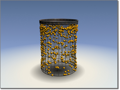

When you use PArray to emit particles using a selected geometric object as the emitter template (or pattern) for the emission, the object is referred to as the distribution object.
Basket used as a distribution object for random particles over its surface
How particles can be distributed on an object:
Left: Edges
Center: Vertices
Right: Faces
