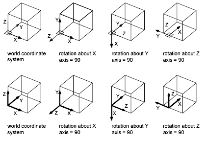

X , Y , Z
Rotates the current UCS about a specified axis.
Point your right thumb in the positive direction of the X axis and curl your fingers. Your fingers indicate the positive rotation direction about the axis.
Point your right thumb in the positive direction of the Y axis and curl your fingers. Your fingers indicate the positive rotation direction about the axis.
Point your right thumb in the positive direction of the Z axis and curl your fingers. Your fingers indicate the positive rotation direction about the axis.
You can define any UCS by specifying an origin and one or more rotations around the X, Y, or Z axis.
