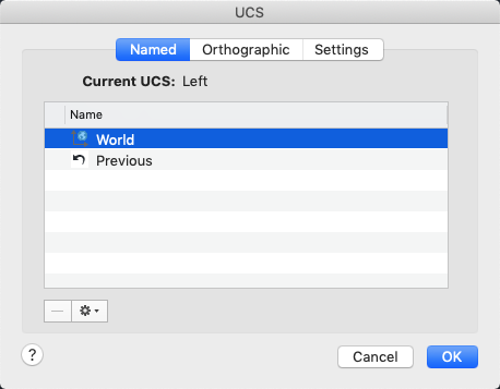

The UCS dialog box includes the following tabs:
Named Tab (UCS Dialog Box)
Lists UCS definitions and sets the current UCS.
Current UCS
Displays the name of the current UCS. If the UCS has not been saved and named, it is listed as UNNAMED.
UCS Names List
UNNAMED is always the first entry if the current UCS is unnamed. World is always listed and cannot be renamed or deleted. If you define other coordinate systems for the active viewport during the current editing session, a Previous entry is next. You can step back through these coordinate systems by selecting Previous and Set Current repeatedly.
To add a UCS name to this list, use the Save option of the UCS command.
Delete (-)
Deletes a named UCS. You cannot delete the World or Previous UCS.
Options
Manages the selected UCS in the dialog box.
Set Current
Restores the selected coordinate system.
Rename
Renames a customized UCS. You cannot rename the World UCS.
Details
Displays the UCS Details dialog box, which displays UCS coordinate data.

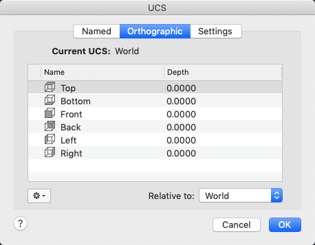

Orthographic Tab (UCS Dialog Box)
Changes the UCS to one of the orthographic UCS settings.
Current UCS
Orthographic UCS Names
Lists the six orthographic coordinate systems defined in the current drawing. The orthographic coordinate systems are defined relative to the UCS specified in the Relative To list.
  • Name. Specifies the name of the orthographic coordinate system.
  • Depth. Specifies the distance between the XY plane of the orthographic UCS and a parallel plane that passes through the origin of the coordinate system specified by the UCSBASE system variable. The parallel plane of the UCSBASE coordinate system can be an XY, YZ, or XZ plane.
    Note: You can specify the depth or a new origin for the selected orthographic UCS. See Depth option.
Relative To
Specifies the base coordinate system for defining the orthographic UCSs. By default, WCS is the base coordinate system.
Whenever you change the Relative To setting, the origin of the selected orthographic UCS is restored to its default position.
If you save an orthographic coordinate system in a drawing as part of a viewport configuration, or if you select a setting in Relative To other than World, the orthographic coordinate system name changes to UNNAMED to distinguish it from the predefined orthographic coordinate system.
Options
Set Current
Reset
Restores the origin of the selected orthographic coordinate system. The origin is restored to its default location (0,0,0) relative to the specified base coordinate system.
Depth
Specifies the distance between the XY plane of the orthographic UCS and a parallel plane that passes through the origin of the coordinate system. In the Orthographic UCS Depth dialog box, enter a value or choose the Select New Origin button to use the pointing device to specify a new depth or a new origin.
Details

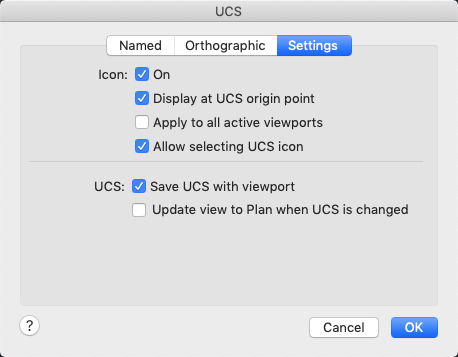

Settings Tab (UCS Dialog Box)
Displays and modifies UCS icon settings and UCS settings saved with a viewport.
Icon
Specifies the UCS icon display settings for the current viewport.
On
Displays the UCS icon in the current viewport.
Display at UCS Origin Point
Displays the UCS icon at the origin of the current coordinate system in the current viewport. If this option is cleared, or if the origin of the coordinate system is not visible in the viewport, the UCS icon is displayed at the lower-left corner of the viewport.
Apply to All Active Viewports
Applies the UCS icon settings to all active viewports in the current drawing.
Allow Selecting UCS Icon
Controls whether the UCS icon is highlighted when the cursor moves over it and whether you can click to select it and access the UCS icon grips.
UCS
Specifies UCS behavior when the UCS setting is updated.
Update View to Plan When UCS Is Changed
Restores Plan view when the coordinate system in the viewport is changed. (UCSFOLLOW system variable)
