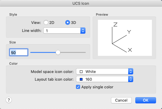

UCS Icon Dialog Box
Controls the style, visibility, and location of the UCS icon.
UCSICON (Command)
Menu: View > UCS Icon > Properties.
List of Options
The following options are displayed.
Style
Specifies display of either the 2D or the 3D UCS icon and its appearance.
2D
Displays a 2D icon without a representation of the Z axis.
3D
Displays a 3D icon.
Line Width
Controls the line width of the UCS icon if the 3D UCS icon is selected.
Preview
Displays a preview of the UCS icon in model space.
Size
Controls the size of the UCS icon as a percentage of viewport size. The default value is 50, and the valid range is from 5 to 95. Note that the size of the UCS icon is proportional to the size of the viewport in which it is displayed.
Color
Controls the colors of the UCS icon in model space viewports and in layout tabs.
Model Space Icon Color
Controls the color of the UCS icon in model space viewports.
Layout Tab Icon Color
Controls the UCS icon color in layout tabs.
Apply Single Color
Applies the selected Model space icon color to all axes of the 2D UCS icon.
