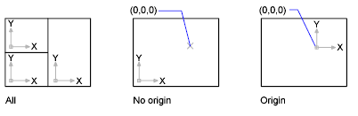

All
Applies changes to the icon in all active viewports. Otherwise, UCSICON affects only the current viewport.
No Origin
Displays the icon at the lower-left corner of the viewport regardless of the location of the UCS origin.
Origin
Displays the icon at the origin (0,0,0) of the current UCS. If the origin is out of view, it is displayed at the lower-left corner of the viewport.
