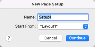

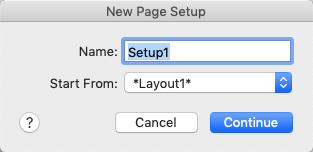

Specifies a name for the new page setup, as well as the page setup to use as a starting point.
PAGESETUP (Command)
Toolbar:
The following options are displayed.
Specifies the name for the new page setup.
Specifies a page setup to use as a starting point for the new page setup. When you click Continue, the Page Setup dialog box is displayed with the settings of the selected page setup, which you can modify as necessary.
Specifies that the default output device is set as the printer in the new page setup.
