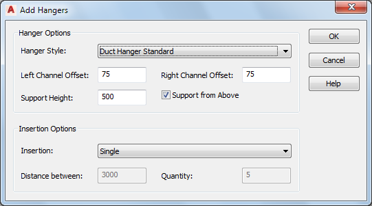

To add hangers
- Start the add command by doing one of the following:
- Open the Tools palette, and click the Add Hanger Support tool, if available.
- On the command line, enter HANGERADD.
- For Hanger Style, select the hanger style to use.
You can select from the hanger styles defined in the current drawing.
- For Left Channel Offset, enter the distance between the left side of the building systems object and the edge of the channel.
Note: The left and right sides of the building systems object are determined by its start point and endpoint.
- For Right Channel Offset, enter the distance between the right side of the building systems object and the edge of the channel.
- For Support Height, enter the height of the drop rods.
- Specify how you want the hangers to provide support:
| If you want the hangers to provide support ... |
Then ... |
| from above the run |
select Support From Above |
| from below the run |
clear Support From Above |
- Under Insertion Options, specify the number of hangers to insert and how to space them:
| If you want to add... |
Then... |
| a single hanger |
for Insertion, select Single. |
| hangers at a specific distance interval |
do the following:
- For Insertion, select Along Run.
- For Distance between, enter the distance between the centers of the hangers.
| a specific number of hangers at a specific distance interval |
do the following:
- For Insertion, select Along Run (Fixed Number).
- For Quantity, enter the number of hangers to insert.
- Click OK.
- In the drawing, select the building systems object to which to add the hangers.
- Click to specify the location of the first hanger.
- If, for Insertion, you selected Along Run or Along Run (Fixed Number), click in the direction you want to place the remaining hangers.
