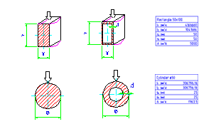

Calculates the moment of inertia for cross sections of cylinders, hollow cylinders, rectangular prisms, or hollow rectangular prisms.
Find
Summary
You select the shape from a predefined list, the dimensions, and the command calculates the moment of inertia along both axes. Unlike with the AMINERTIA command, you don't have to select anything from the drawing area.
The Predefined Profile Sections dialog box is displayed. You can display four predefined cross sections for calculating moments of inertia.
