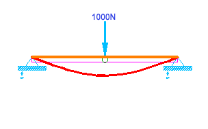

Calculates and draws the deflection line or moment line of a beam that is subject to various forces.

Starting point
Specifies the starting point for drawing a new beam, for which the command draws the deflection line and moment line.
Note: A side view is symbolically represented as a line.
End point
Specifies the end point of the beam.
Existing beam
Specifies an existing beam to draw the deflection line and moment line.
Scale for deflection line
Specifies the scale for the deflection line in the form unit:mm.
Scale for moment line
Specifies the scale for the moment line in the form unti:Nm
