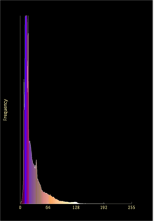

Widget Available Settings Image
Histogram Video: Displays the tonal values of your image on a linear scale, between 0 and 255.
In the Scopes Settings, you can select the histogram's range in the Preset Widgets tab.

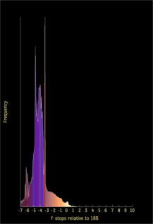

Histogram F-Stop: Displays the tonal values in terms of the number of photographic stops (f-stops) relative to 18% grey. These are the traditional units photographers/cinematographers use to judge lighting and exposure in a scene. Each stop represents a factor of two (doubling or halving) of the amount of linear light, or exposure.
  • Colours in log colour spaces are linearized before calculating the waveform.
  • Requires scene-linear or log colour spaces. It is incompatible with Video, Data, or Unknown color spaces.

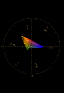

Vectorscope
Video CbCr: This Vectorscope displays the value of a colour relative to the boundaries of its specific integer encoding (in Colour mode).

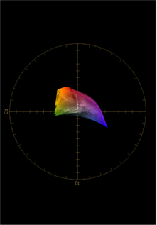

Vectorscope
Dolby CtCp: The chroma axes from Dolby's ICtCp colour space (also part of Rec.2100). This space was specifically developed for HDR video applications.

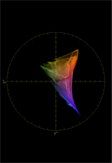

Vectorscope
CIELAB a*b*: The chroma axes from the CIELAB colour space. This is a roughly perceptually uniform space that is used in Photoshop and in ICC colour management. This colour space was developed before the advent of HDR video.

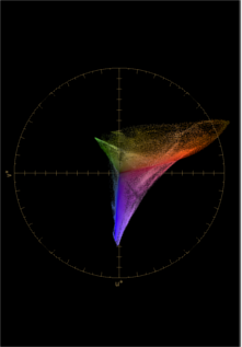

CIELUV u*v*: The chroma axes from the CIELUV colour space. This is a companion space to CIELAB - similar but more oriented towards video applications. It is essentially a CIE u'v' chromaticity diagram that is scaled by lightness so that the gamut converges to a point at black. This colour space was developed before the advent of HDR video.

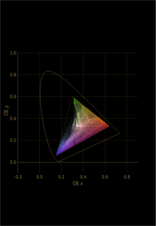

Vectorscope
CIE xy: This is the classic CIE chromaticity diagram. It allows comparison of colours in relation to a gamut boundary. The points on the graph represent colour independent of luminance. Blends between two colours in scene-linear space fall on a straight line on this graph.

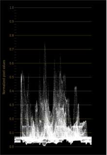

Waveform
Video: This Waveform displays the dynamic range values of SDR Video.

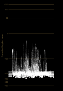

Waveform
Log: This waveform displays a very wide range of floating-point values via a pseudo-logarithmic scaling on the vertical axis. It allows you to quickly check the maximum values of your media even if these are much larger than 1.0. It also allows you to quickly check for negative values.

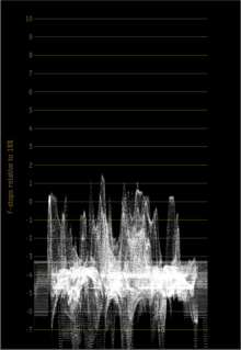

Waveform
F-Stop: For this waveform, the colours in the media are displayed in terms of the number of photographic stops (f-stops) relative to 18% grey. These are the traditional units photographers/cinematographers use to judge lighting and exposure in a scene. Each stop represents a factor of two (doubling or halving) of the amount of linear light, or exposure.
  • Requires scene-linear or log colour spaces. It is incompatible with Video and Data color spaces.

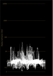

PQ: This waveform displays the luminance of a video signal in units of nits (also known as candelas per square meter).
  • The vertical axis is scaled using the SMPTE ST-2084 "Perceptual Quantizer" function, which is pseudo-logarithmic in nature.
  • This waveform is intended for graphing HDR video media that are already in a PQ space.
  • Other colour spaces are linearized and then the PQ encoding is applied for the waveform.
  • For SDR video signals, the white point is normalized to 100 nits.

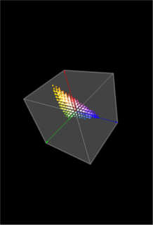

3D Cube
3D Cube
  • You can choose between the following sizes: 8x, 16x and 32x, Preset Widgets tab of the Scopes Settings.
