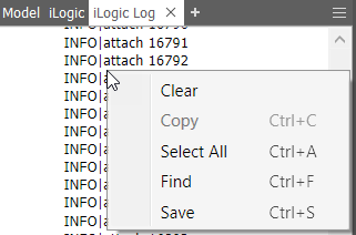

  5. Right-click in the iLogic Log panel to access the context menu options. Context menu options provide additional options for working with the messages. For example, use the context menu option Clear to clear the current state of the window.
    Tip: Messages created in the iLogic Log panel do not persist across sessions. Use the context menu option, Save, to save the messages generated in the current Inventor session to a permanent file.

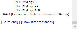

After you clear messages from the panel, navigation links display at the top of the panel if older messages are available. The iLogic Log panel is limited to displaying 20,000 messages at one time. When over 20,000 messages are entered, navigation links at the bottom of the panel allow you access messages created after reaching the 20,000 limit.

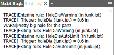

Rule-tracing helps you to visualize when and why a rule is run. Rule Tracing automatically logs messages when a rule is entered and when it is exited, as well as what triggers the rule to run. Simply set the active log level to Trace to see these messages. Set the active log level back to turn them off.
Rule-tracing helps you to visualize when and why a rule is run. Rule Tracing automatically logs messages when a rule is entered and when it is exited, as well as what triggers the rule to run. Add the following line to a rule to enable tracing:
Tip: Use Logger.Debug statements, for normal debugging. Only use Logger.Trace statements when you need very detailed debugging information. Rule tracing behavior is very detailed and the output can look daunting. Only use Trace level when you need that much detail.
Example of rule tracing output
Select Detailed Trace in the Logic Rule Editor dialog box to automatically generate log messages when running a rule at the Trace level. This setting controls the value of the API property iLogicVb.Automation.LogControl.RuleEntryExitMessageLevel.
