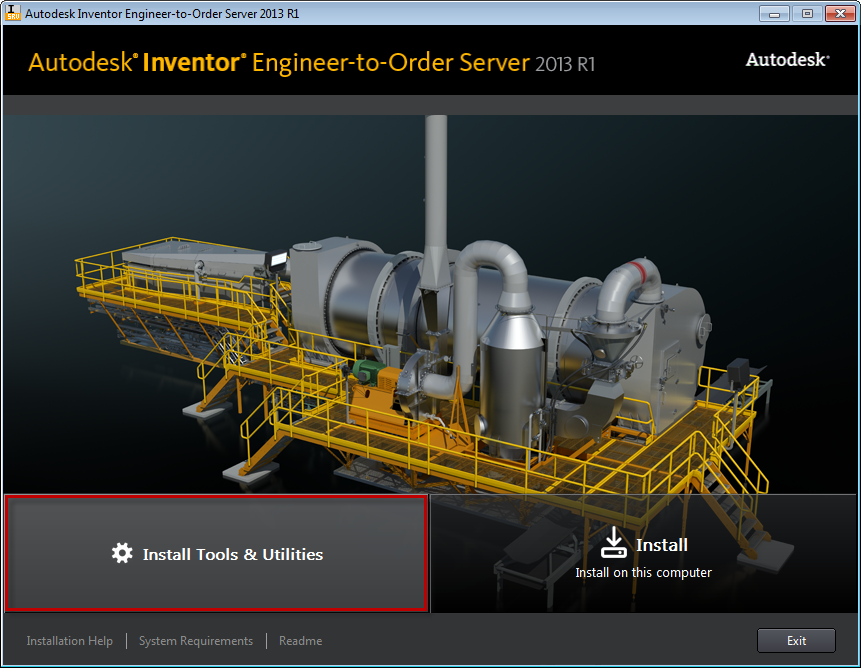

  1. To install the network license manager, launch the Inventor ETO Server installer, and select Install Tools & Utilities.
  2. On the Configure Installation page, select Network License Manager, click Install, and follow the instructions. For more information, see the LicenseAdministration.pdf file.
