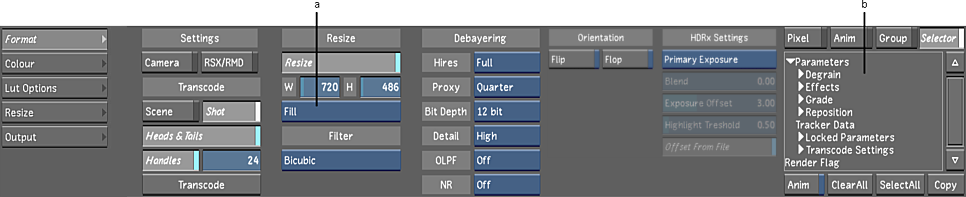

Transcode Format Settings
(a) Fit Method option box (b) Selector 
Note:The Settings and Transcode panel options are also available in the Colour and Output settings tab.
