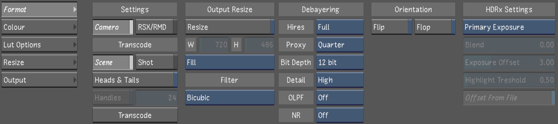

The Transcode menu is divided into five submenus.
Note:The Settings and Transcode options are available within the Format, Colour, LUT Options, Resize and Output settings tabs.
Format
Sets the high-level options for the media decoding (e.g., debayering, resizing, filter, etc.). This submenu is exclusive to RED and ARRIRAW media. See Transcode Format Settings.
