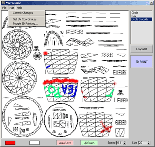

In this even more exciting step of the Bitmap Painting tool development, we will add the option to directly paint on a scene object in the 3ds Max viewports.
NATURAL LANGUAGE
We will add a new checkbutton to the User Interface to enable and disable the 3D Painting.
We will define a couple of simple functions using thePainterInterface to control the brush in the viewport, read the UV coordinates of the faces it is painting, and draw in the corresponding area of the bitmap.

menuItem uv_menu "Get UV Coordinates..." menuItem paint3d_menu "Toggle 3D Painting..."
This is the new "Toggle 3D Painting" menu item. We will also add a very prominent button to the main User Interface...
on commit_menu picked do copy theCanvasBitmap theBackgroundBitmap
on uv_menu picked do MicroPaint_CanvasRollout.unwrapTexture() on paint3d_menu picked do MicroPaint_CanvasRollout.startPainting3D()
This is the handler of the new "Toggle 3D Painting" menu item. It calls a function that will toggle the PainterInterface on and off.

) checkbutton paint3D "3D PAINT" width:90 height:50 highlightcolor:(color 200 200 255) pos:[bitmapX+5,180]
This is the new checkbutton controlling the painting in 3D space. It will turn blue when enabled.

RESULT:
You can paint on both the 3D object and the 2D image at the same time.
