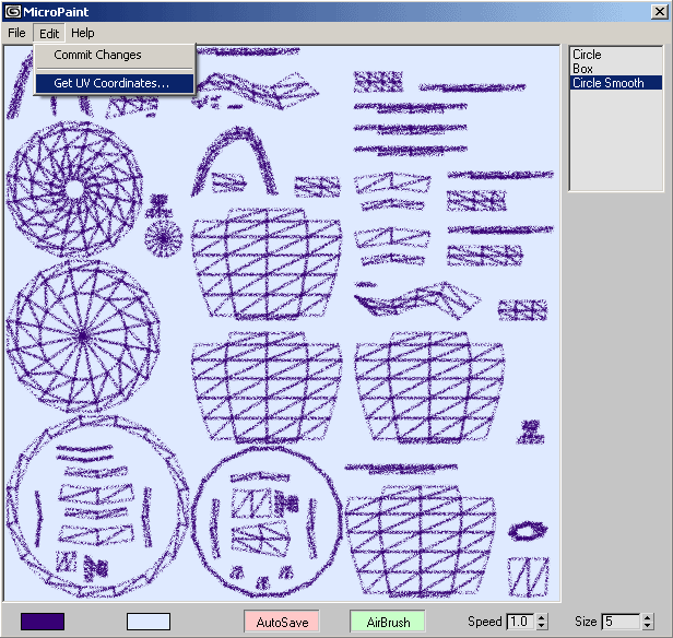

menuItem uv_menu "Get UV Coordinates..."
We add a new menu item that will be used to acquire texture coordinates from a scene object.
on commit_menu picked do copy theCanvasBitmap theBackgroundBitmap on uv_menu picked do MicroPaint_CanvasRollout.unwrapTexture()

fn unwrapTexture =
This is the new function that performs the selection of an object, the unwrapping of the texture coordinates, and the material/texture assignment.
if theObj != undefined then
If the user clicked a valid object,
theMesh =snapshotAsMeshtheObj
we extract the mesh from the top of its stack.
if meshop.getMapSupport theMesh theChannel do
If the selected object supports the specified channel,
faceCount = meshop.getNumMapFaces theMesh theChannel
we read the number of texture faces in that channel,
for f = 1 to faceCount do
and repeat the following code for every face found in the mesh:
theFace = meshop.getMapFace theMesh theChannel f
This is the map face definition. It returns a Point3 value where .x, .y, and .z are indices pointing at the texture vertices the face is using.
vert1= meshop.getMapVert theMesh theChannel theFace.x
vert2= meshop.getMapVert theMesh theChannel theFace.y
vert3= meshop.getMapVert theMesh theChannel theFace.z
Using this data, we read the three vertices of the face. Each one is a Point3 value containing the actual U, V, and W values. We will draw only the UV and discard the W.
drawStroke [vert1.x * bitmapx_1, bitmapy_1- vert1.y * bitmapy_1] [vert2.x * bitmapx_1, bitmapy_1- vert2.y * bitmapy_1] drawIt:false
We call the drawStroke function using the first and second texture vertex coordinates multiplied by the size of the bitmap. The flag drawIt is set to false to speed up the generation of the image. If you change it to true, you can watch the function drawing interactively in the image, but this can take a very long time.
The calculation of the coordinates is based on the fact that the lower left corner of the UV space has coordinates 0,0 and the upper right has coordinates 1,1.
The bitmap on the other hand has its upper left corner as 0,0 and its lower right corner as bitmapx-1, bitmapy-1 (511,511 in our example).
So, to convert the UV coordinates in pixel coordinates, we multiply the width resp. height of the bitmap by the U resp. V value, and turn the vertical result upside-down by subtracting from the height.
drawStroke [vert1.x * bitmapx_1, bitmapy_1- vert1.y * bitmapy_1] [vert3.x * bitmapx_1, bitmapy_1- vert3.y * bitmapy_1] drawIt:false
drawStroke [vert3.x * bitmapx_1, bitmapy_1- vert3.y * bitmapy_1] [vert2.x * bitmapx_1, bitmapy_1- vert2.y * bitmapy_1] drawIt:false
We call the drawStroke function for the other two pairs of vertices, thus drawing all edges of the face.
theCanvas.bitmap = theCanvasBitmap
Now, we can update the rollout bitmap to show the result.

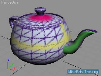

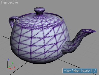

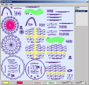

RESULT:
In this example, Unwrap UVW modifier is applied to a teapot and the Flatten function is used to create the new texture coordinates.
Then, the object is selected in MicroPaint and the texture coordinates are drawn using the Circular Smooth brush with size 5, Airbrush turned on, and Airbrush Speed set to 1.0.
This is the teapot as seen in the viewport:
Now, you can start painting on top of the UV coordinates using all available brushes - as long as the AutoSave button is checked, all your strokes must update in the viewports:
