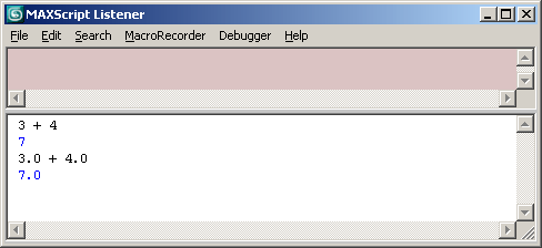

When MAXScript performs numerical operations, the result is generally the same number-type as the arguments in the operation.
For example: 3 + 4 will return 7, while 3.0 + 4.0 will return 7.0.

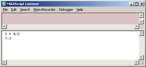

When MAXScript performs operations involving both float and integer-type numbers however, it treats the integer as a float number.
For example: 3 + 4.0 will return 7.0.

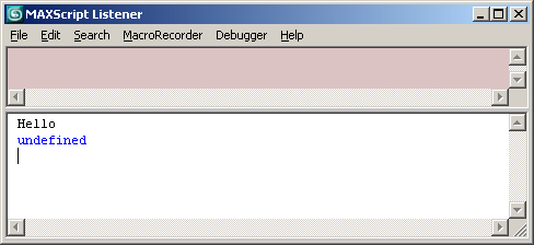

With the MAXScript Listener window open, say hello to MAXScript:
At the prompt, type Hello and press ENTER on the numeric keypad.
  MAXScript answers with undefined. This is called command output, which always appears in blue. The reason for this specific output is that MAXScript doesn’t know the word Hello. It is not defined in the language and therefore MAXScript cannot determine what to do with it.

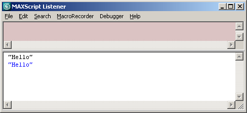

Write the word "Hello" again, this time with quotation marks, and press ENTER.
  The command output is now "Hello".
It seems that MAXScript knows the string "Hello" because it answers with a friendly "Hello" Actually, it merely knows that you entered a string, and the command output for strings is always the value of the string you entered.

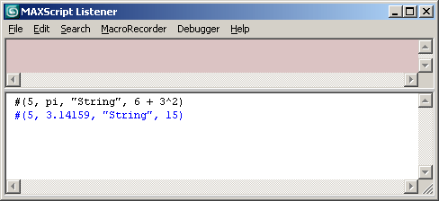

#(<expr> , <expr>)
This form of the array is appropriate when you would like to define one or more of the initial elements within the array.
Each value of <expr> can be a number, an expression (e.g., sin pi, 6.2^3), or a string (e.g., "hello").
Elements do not have to be the same type of information, and there is no limit on the number of elements you can have in an array.
