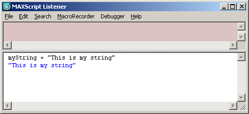

At the Listener prompt, enter the following command:
  mystring = "This is my string."
MAXScript returns the value of the string variable:

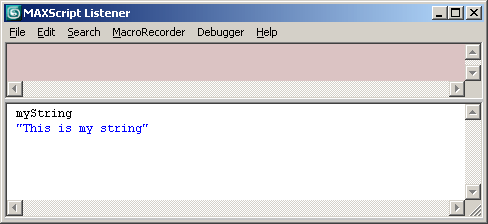

You can now refer to this string variable by entering the variable’s name. Enter mystring.
MAXScript again returns the value of the string variable:
This is faster than entering the string again. MAXScript remembers this string for as long as your 3ds Max session is open, or until you change the variable’s value.

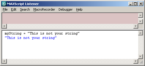

Enter mystring = "This is not your string."
  MAXScript now displays the new value of mystring:

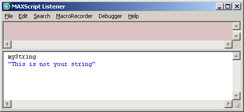

When you refer to mystring now, MAXScript uses the new value. Enter mystring.
MAXScript now displays the new variable value:
Notice that MAXScript doesn’t distinguish between lowercase and uppercase variable names because MAXScript names are not case-sensitive. Thus, entering myString is the same as entering mystring or MYSTRING or MyStRiNg.
