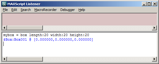

mybox = box length:20 width:20 height:20
MAXScript returns the box object name and the position of the box:
This example creates a box, and supplies three parameters: the length, width, and height of the box. The parameter names are followed by a colon and then by the value for that parameter. You can enter all parameters, without any punctuation between them.
MAXScript returns the following statement:
$Box:Box001 @ [0.000000,0.000000,0.000000].
