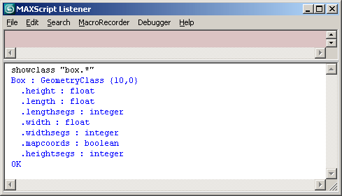

The Parameters rollout shows all the creation parameters for a box. You can change them using the spinners in the rollout. If you want to change the value of the length, width, and height segments, or the setting of the mapping coordinates in MAXScript, you need to know the syntax for these parameters. In order to find the syntax for all of the parameter settings, there are two different inspector functions.
The first of these is showclass().
The showClass() function prints information about a specified 3ds Max class or classes. The information entered in the parentheses is a string containing a wild-card pattern to match against 3ds Max class names, superclass names, and property names.
ENTER:
showclass "box.*"
MAXScript shows all the box parameters that are equivalent to the ones you see in the Parameters rollout, including which object class the box object belongs to, and the data type that each parameter requires:
Notice that you can use the "*" character as a wildcard to see all box parameters. If you had entered showClass "box*.*," MAXScript would have listed all of the parameters of theBox and the BoxGizmo classes.
