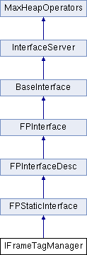

+ Inheritance diagram for IFrameTagManager:

Detailed Description
Description:
IFrameTagManager exposes the FrameTagManager
Member Function Documentation
◆ GetTagCount()
virtual int GetTagCount ( )
pure virtual
Get number of frame tags.
◆ GetTagID()
virtual DWORD GetTagID ( int  i)
pure virtual
Get ID for the i'th frame tag in the list of frame tags.
Remarks
the list is maintained in sorted order, so a given tag can move around in the list. Each tag has a unique ID, so all access to the tag is via this ID
Returns
The ID of the tag at index i
◆ GetTimeByID()
virtual TimeValue GetTimeByID ( DWORD  id,
BOOL  relative
pure virtual
Get the tag's time value.
Parameters
id- The id of the tag to query
relative- if TRUE, time is relative to the tag this tag is locked to, if any. If false, or this tag is not locked to another tag, the time is absolute
◆ SetTimeByID()
virtual void SetTimeByID ( DWORD  id,
TimeValue  newTime,
BOOL  relative
pure virtual
Set the tag's time value.
Parameters
id- The id of the tag to set
