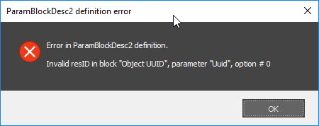

Localized names of ParamBlock2 (PB2) parameters are now tested to ensure they use resource ids instead of string literals.
Using string literals instead of resource id generates the following error:
This means that the definition for parameter 'Uuid' in ParamBlockDesc2 'Object UUUID' has an invalid resource id for the localized name. Most likely the name was specified as a string literal instead of a resource id. For example:
XRefMaterial::pbEnableOverride, _T("enableOverride"), TYPE_BOOL, 0, _T(""),
should be:
XRefMaterial::pbEnableOverride, _T("enableOverride"), TYPE_BOOL, 0, IDS_XREFMATERIAL_ENABLE_OVERRIDE,
or
XRefMaterial::pbEnableOverride, _T("enableOverride"), TYPE_BOOL, 0, 0,
A resource id of 0 in this context is interpreted as a null string. Valid resource id values are in the range of 0 to 65535.
