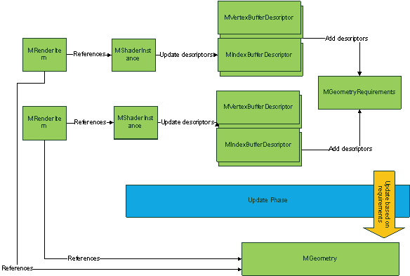

Revisiting the Update Phase, the main pieces can now be filled in as follows:
Figure 26
Instead of a “shader”, an MShaderInstance
instance is referenced by an MRenderItem
. The geometric attributes of the shader represented by the MShaderInstance
provides set of vertex and index descriptors which specify the requirements to be used during update.
The pipeline in which the update and draw phases reside could look as follows:
Figure 27
