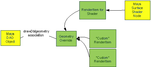

Implementations of MPxGeometryOverride must be registered with MDrawRegistry using classification strings. The classification string must begin with “drawdb/geometry” in order to be properly recognized by the system. DAG objects whose classification string satisfies the override classification string are evaluated using the override. Maya creates one instance of the registered MPxGeometryOverride for each associated DAG object.
Figure 38: An MPxGeometryOverride is associated with a given DAG object by its classification string. Shown is a possible configuration where render items from an internal surface shader as well as custom render items are part of the set of render items that the override would handle.

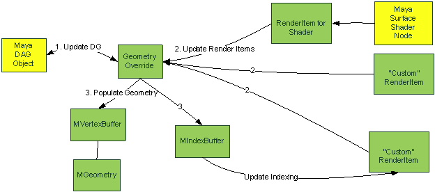

The interface is divided into several sections or phases. The first phase is updateDG(), where all attribute data from the associated Maya DAG object must be queried and cached. It is invalid to attempt to query attribute data in the final populateGeometry() phase, and such behaviour may result in instability. This separation keeps dependency graph evaluation separate from graphics device access in order to facilitate multi-threaded update.
The second phase is updateRenderItems(). During this phase the override is given a list of pre-created render items, one for each supported shader assigned to the object. The override may disable those render items and/or add additional render items to augment the display of the object. Additional render items need to be associated with shaders using the MShaderInstance interface. The shaders from each render item determine the total set of geometry requirements that the override needs to fulfill during the populateGeometry() stage. In MPxGeometryOverride, additional render items are comparable to the old MDrawRequest interface.
The third phase is populateGeometry(). During this phase, the override is given the list of geometry requirements it needs to satisfy, as well as the list of render items that generated those requirements. The override must fill the provided MGeometry structure with vertex buffers (MVertexBuffer) to satisfy the requirements. It must also produce an index buffer (MIndexBuffer) for each render item. The index buffers are stored on the MGeometry object and must also be directly associated with their corresponding render item using MRenderItem::associateWithIndexBuffer().
Figure 39: The three phases are used to label the connections between the main constructs which are involved in the update of an MPxGeometryOverride. The first phase (1.) involves accessing the associated DAG object. The second phase (2.) updates the render items and determines the geometry requirements. The third phase (3.) updates vertex and index buffer data and the indexing association for each render item. In this example, three render items drive the update requirements: one for an associated surface shader and two for custom render items that the override wishes to draw.
