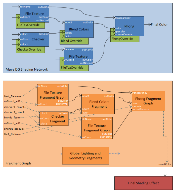

The responsibility of a shading node override is to define a hardware shading fragment to be associated with a software shading node. Ideally, the fragment has input parameters which correspond exactly to the input attributes on the node and output parameters, which correspond exactly to output attributes on the node. This is not always possible; normally, hardware fragments support a subset of the functionality of the software shading node. Whenever possible, a shading node override should be able to operate in isolation using only information from the shading node it is operating on. It should not need to know anything about other nodes in the shading network.
When translating a shading network for display in Viewport 2.0, Maya traverses upstream in the dependency graph in a depth first manner, starting with the surface shader connected to the shading engine. For each node it visits, it creates an instance of the shading node override associated with the node type. The override created may be internal or defined by a plug-in (the system sees no difference between the two). After creating an override for a node, Maya requests the name of the fragment or fragment graph to be used for the node from the override. It then connects the fragments together in a graph which approximates the DG connections of the nodes in the Maya shading network. Once fragments for all nodes in the network are created and connected together, Maya connects some global fragments for lighting and geometry information and then compiles the final fragment graph into a shading effect. This shading effect is then applied when drawing scene objects to which the original surface shader has been assigned. If there is a problem translating any node in the network (for example, no override, bad fragment, unable to form connections), then Maya simply prunes the translation at that node; and as a result, the sub-network rooted there provides no contribution to the final shading effect.
When there is a change to an existing shading network, the override system is again invoked. If the change alters the topology of the Maya shading network; or, if an override for a node in the network specifies that the change is equally large, then the pre-existing overrides are all deleted and the translation is redone from scratch. If the change is simply a change to an attribute value, then the overrides are invoked to update the values of any parameters on the final shading effect that correspond to the parameters on the original fragments. Much of the value updating is handled automatically by Maya, but this can be overridden in a specific implementation where needed.
Since Maya sees no difference between internal and plug-in shading node overrides, implementing MPxShadingNodeOverride for a plug-in software shading node is the best way to provide a Viewport 2.0 representation that works with all of the Viewport 2.0 systems. Lights, shadows, screen-space effects, transparency, acceleration structures and integration with unrelated plug-ins all work automatically.
Figure 43: Shows a non-trivial Maya shading network and how it is translated to a hardware fragment graph which is used to create the final shading effect. Each shading node has an associated shading node override. The override specifies the hardware fragment or fragment graph to be created for the node. Those fragments are joined together, along with some global lighting and geometry fragments, to produce a final fragment graph. The input parameters of the graph drive the input parameters of the contained fragments.
