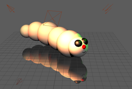

The example plug-in does the following:
Refer to pyGroundReflectionRenderer.py
for the plug-in example.
This example creates a Ground Reflections renderer in the Renderer viewport panel menu. When you switch to the Ground Reflections renderer, the viewport updates to render your object and its reflection.
