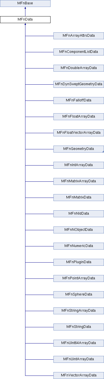

Inheritance diagram for MFnData:Public Types | |

virtual |
Function set type.
Return the class type : MFn::kData.
Reimplemented from MFnBase.
Reimplemented in MFnFalloffData, MFnPluginData, MFnNurbsSurfaceData, MFnDynSweptGeometryData, MFnNurbsCurveData, MFnSubdData, MFnMeshData, MFnNumericData, MFnArrayAttrsData, MFnDoubleArrayData, MFnFloatArrayData, MFnSphereData, MFnGeometryData, MFnNIdData, MFnComponentListData, MFnFloatVectorArrayData, MFnIntArrayData, MFnMatrixArrayData, MFnMatrixData, MFnPointArrayData, MFnStringArrayData, MFnStringData, MFnUInt64ArrayData, MFnUintArrayData, MFnVectorArrayData, MFnLatticeData, and MFnNObjectData.
