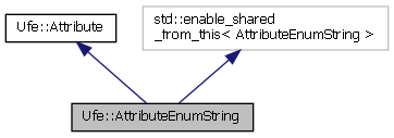

Attribute which has a list of strings as enumerated values.
More...
#include <attribute.h>
Definition at line 109 of file attribute.h.
