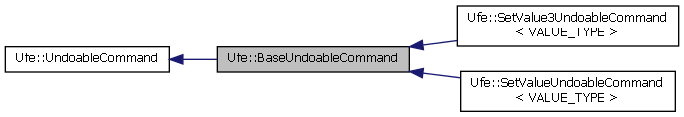

Universal Front End is a DCC-agnostic component that will allow a DCC to browse and edit data in multiple data models
Base class for undoable set operation commands. More...
#include <baseUndoableCommands.h>
Definition at line 32 of file baseUndoableCommands.h.
