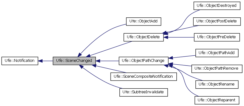

#include <sceneNotification.h>
Inheritance diagram for Ufe::SceneChanged:
Collaboration diagram for Ufe::SceneChanged:

Detailed Description
Base class for all scene notifications.
This class is the base class for all scene changed notifications.
Definition at line 25 of file sceneNotification.h.

◆ changedPath()
virtual Path Ufe::SceneChanged::changedPath ( ) const
virtual
Returns
Path to the object that was changed. In the case of a composite notification, this path will be empty.
Reimplemented in Ufe::SceneCompositeNotification, Ufe::SubtreeInvalidate, Ufe::ObjectPathRemove, Ufe::ObjectPathAdd, Ufe::ObjectReparent, Ufe::ObjectRename, Ufe::ObjectDelete, and Ufe::ObjectAdd.
