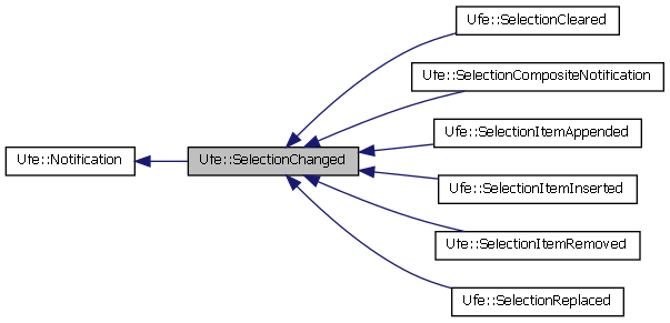

Inheritance diagram for Ufe::SelectionChanged:
Collaboration diagram for Ufe::SelectionChanged:

Detailed Description
Base class for all selection notifications.
This class is the base class for all selection changed notifications.
