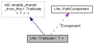

Inheritance diagram for Ufe::TrieNode< T >:
Collaboration diagram for Ufe::TrieNode< T >:

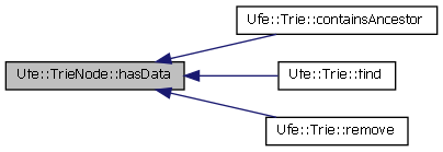

◆ hasData()
template<typename T >
bool Ufe::TrieNode< T >::hasData ( ) const
Definition at line 174 of file trie.imp.h.
Referenced by Ufe::Trie< T >::containsAncestor(), Ufe::Trie< T >::find(), and Ufe::Trie< T >::remove().
Here is the caller graph for this function:
